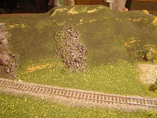

Next I added some Woodland Scenics Coarse Turf to the Mountain.

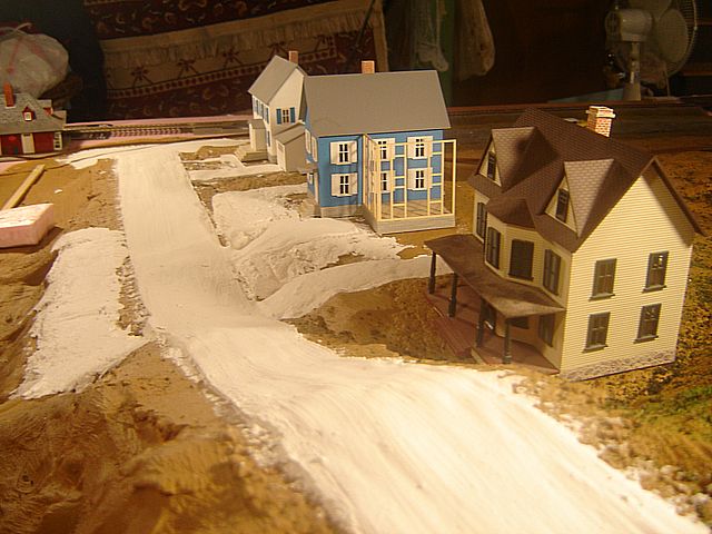

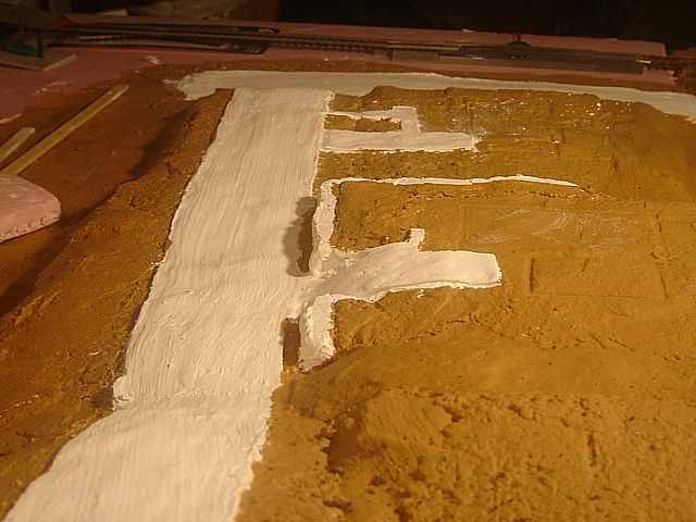

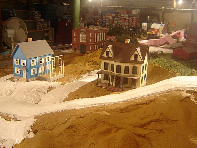

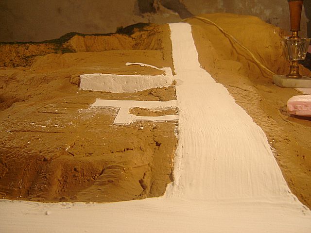

Using Woodland Scenics Smooth-it I made driveways and walkways for the house along the road. Using Sculpta-mold I also smoothed out some rough areas.
Nazgul
Tom...
looking great!....I really like the formation of the land where you are putting the houses...looks so right! Everything is top notch:thumb: :thumb:

wickman said:
The smooth it looks real good for roads. Would you use the smooth it for dirt roads or would that be a waste?:wave:
I am not sure. In the past I have used WS turf, usually Soil or Earth for my dirt roads. I guess you could use it. You may have to texture it some.
I know some folks use Dura-putty or at least that what I think it is called for their dirt roads. They put the putty down and then color it.
I've seen the WS gravel and soil used for dirt roads as well, but somehow it hasn't looked right to my eyes. I used a brown gravel for a road surface but the particles seem too large somehow. So I'd be inclined to use a smooth surface material like spackle, then dabbed with a wet sponge to give it just a little texture then let color do the rest. The lightweight spackle I've used for a scenic base will dry to the same color it is when wet, when acrylic craft paint is used to color it.
Lookin' good Tom! How are you going to color your roads?
I will use craft paints. I will start with a dark gray for the whole road. I then will drybrush various shades of gray and/or black over the road high-lighting the wheel paths. I will work from dark to light.
For the yellow lines and whites lines I will use paint pens.

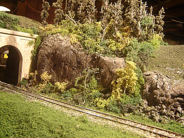

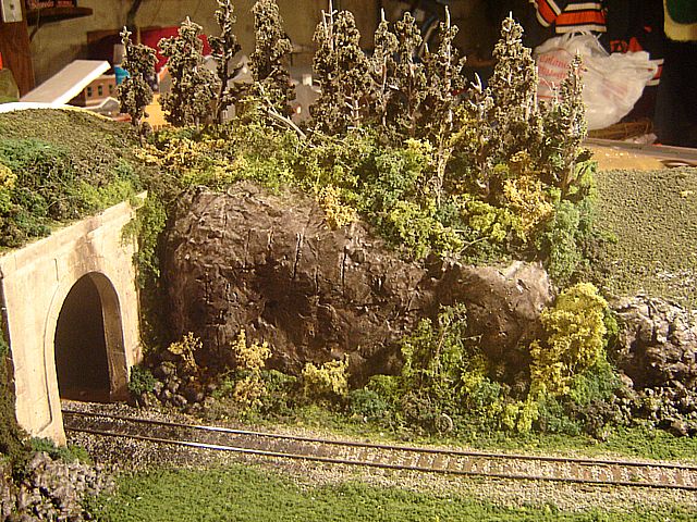

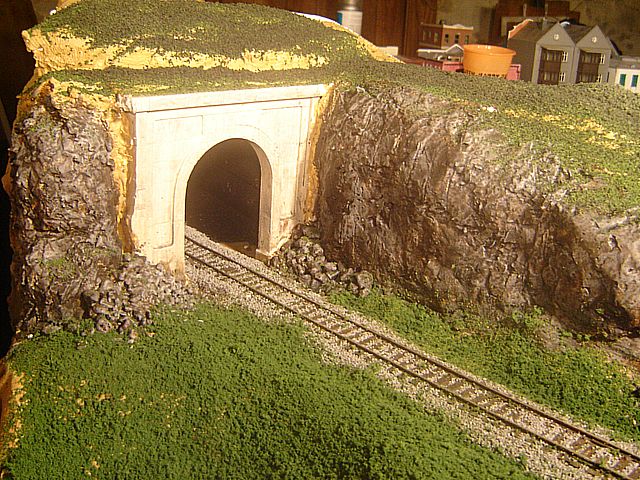

I added some Fine Leaf Foliage, fine Foliage and Clump Foliage around the tunnel portal.
I repainted the areas I had to fix or Smooth-it got on.
Nazgul
Tom...
That tunnel portal looks awesome:thumb: :thumb: :thumb: ....may I ask what steps you take to get your ground cover to stick to vertical surfaces? I'm doing it myself but it ain't easy! I was hoping you had a better way

TomPM
Another Fried Egg Fan
Thanks!
Thanks
I am using Woodland Scenics Foliage. It is like a netting that you stretch out to cover the area you want. It works great for vertical spots and as a vine. It comes in four colors:
Light Green
Medium Green
Dark Green
Conifer Green
