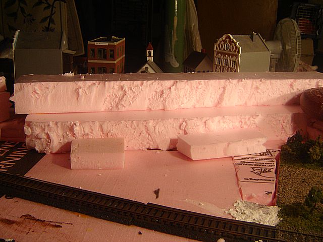

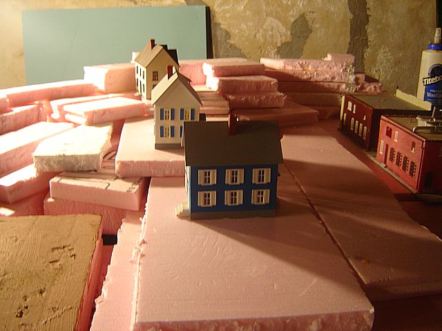

The next area that I need to work on is what I call the Mountain. I need to do this now because it is in the background and I don’t want to complete too much of the Hillside and then have to reach across the hillside area to work on the Mountain. The mountain will also serve as scenic separator for the layout.
Here is the area before.

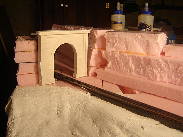

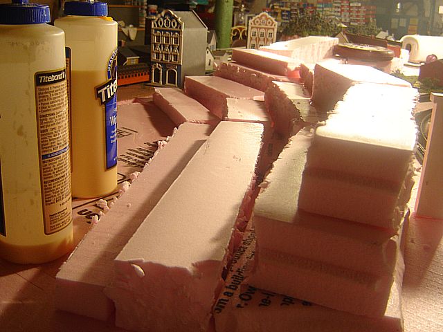

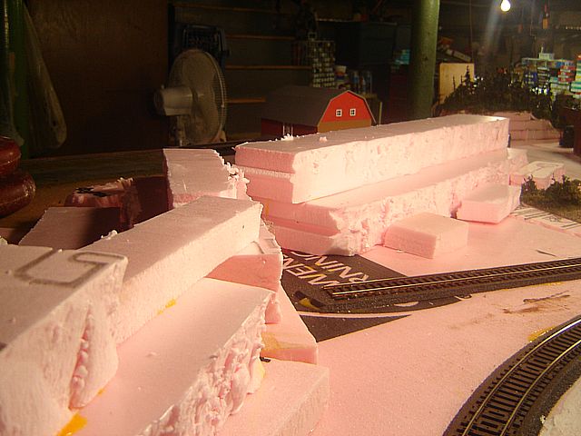

I now have some of the foam down for the base of the mountain and for the tunnel portal.

Tom, --I'm going to enjoy watching the progression of the mountain and associated landscaping. Looking forward to using the foam sheets for the depth I'll need so that cuts can be made for bridges and hills built up in the background. You guys are all so good about posting pics of the progress on your layouts and the exchange of ideas is extremely helpful---Keep posting the photos---Thanks, John R

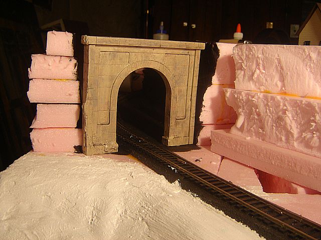

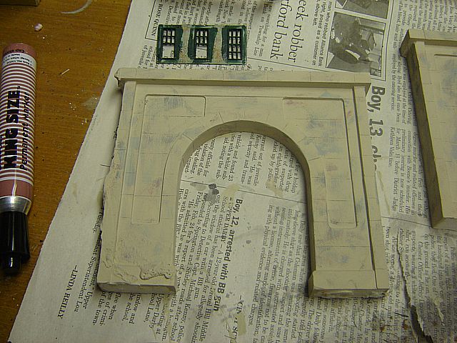

Now here are the tunnel portals. They are from Woodland Scenics. I painted them with Folk Art Clay Bisque. I then dry brushed spots and streaks with Folk Art Huckleberry, Amish Blue, and Dark Gray. Next I painted over them with Folk Art Linen thinned 1:1 with blue windshield washer fluid.
Next is weathering.

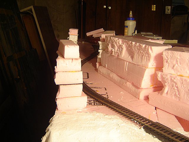

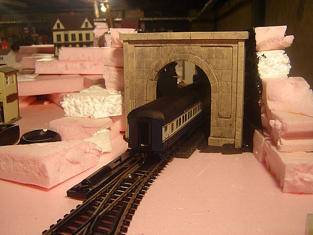

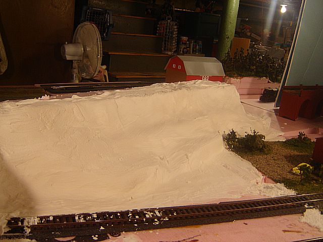

Here is the almost all of the foam base done for the mountain.

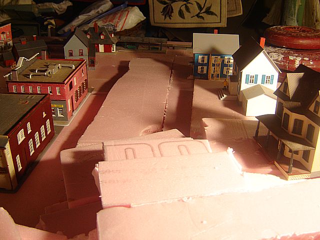

The next photos show the area where there will be a road that crosses the tunnel area.

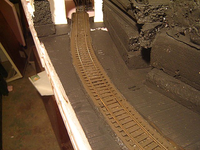

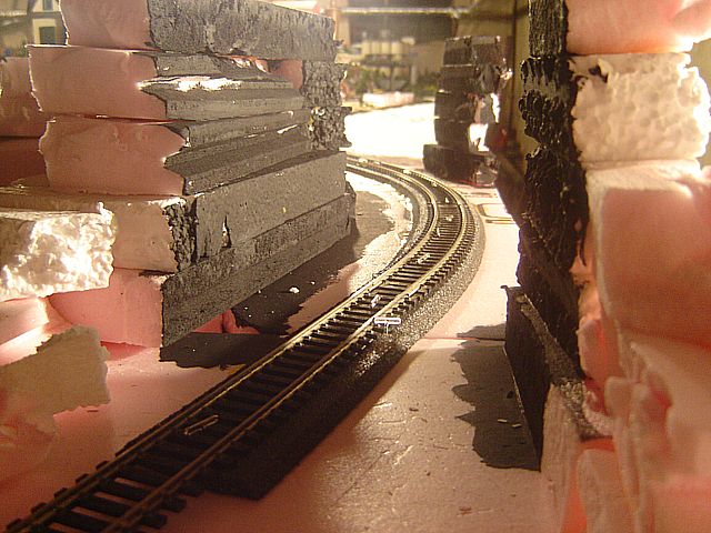

I painted the inside walls of the tunnel black. I also tacked down the road bed.
Next is to finish painting the bottom of the tunnel black and attach the tack.

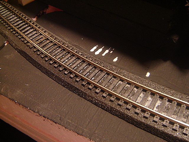

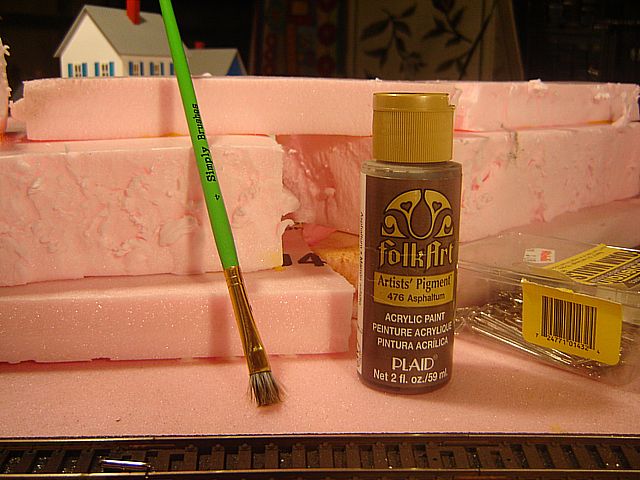

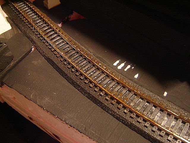

I had a request to show some of how I weather my track. Since I need to do the piece through the tunnel before putting the top on I thought I could show how I weather the track.
My tools: A paint brush and Folk Art Asphaltum:
The track before I begin.
I paint the “far” side of the track and the ties with the Asphaltum straight out of the bottle; no thinning.
TomPM
Another Fried Egg Fan

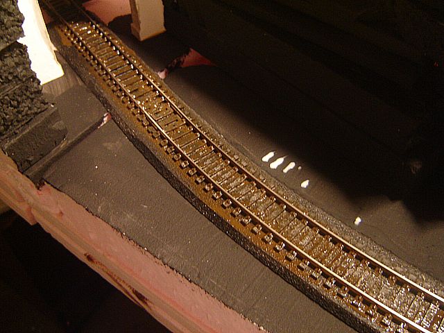

Next I paint the “near” side of the rail and ties, and the ties between the rails.
Now I clean off the rails.
Now let everything dry. I will have to do a second coat.

Thanks Tom Here I thought it was some magical method of painting.
I had tried some painting on my tracks today using boxcar red with a number 0 brush but unless your flash makes yours look more brite and rusty compared to a box car red I would have to say your paint choice is better. The pic is hard to tell and although the color of your previously painted tracks look perfect is the color comparable to box car red?
I had actually thought the ties may have been a brownish color, thinking of which the other day I crossed some tracks outside of the city limits here and to my amazement there was a rust color going down the middle of the ties.
Will you be ballasting in this section or dah probably not seeing as it'll be in the tunnel :eek:ops:
Yes I will. I thought about it and figured that for photos I will need to ballast a good portion of the track.

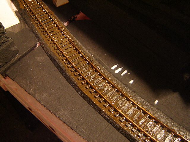

I completed the second coat of paint and the track weathering is done.

I picked up a nifty little track weathering trick once (for after the rails have been painted though): After ballasting and the glue is all dry, I take an old toothbrush and scrub between the rails. That really weathered it nicely, since it took pigment from the ballast and distributed it across the ties. Gave it an oily, sooty color that looks pretty nice.
At any rate, that's how *I* weather track after the ballasting is done and the track has been painted.

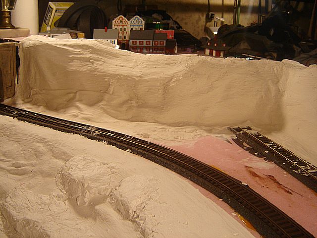

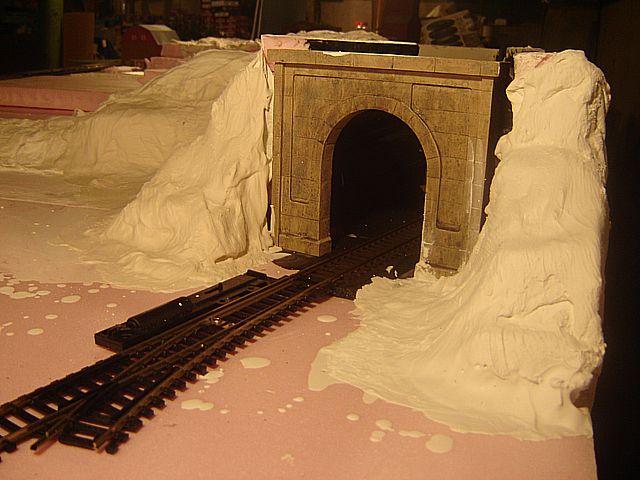

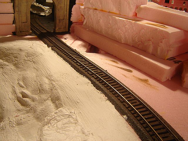

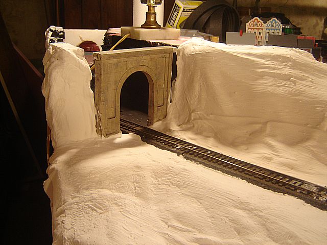

I have placed the paper towels with plaster. I have then gone back over the towels and “painted” a layer of plaster of Paris.
Next is using Sculpta-mold to fill in the gaps around the tunnel portals and to make rock faces.
