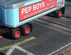

From a guy who lives in hurricane country to a guy who lives in typhoon country, asphalt shingles can be a plentiful commodity to use for model roads. I use the back of them, cut to size, weathered with chalks and lined with Elmer's yellow and white paint pens. The grade crossing how-to can be found here>>> http://www.the-gauge.com/showthread.php?t=16462

Triplex
Wow. That's an interesting technique, and not one you usually see in books. It looks quite realistic - it should, since it's the same material as the real thing. The chalk markings look good. The texture of the road gives them that speckly, worn look like they have in reality. My only quibble would be that roads aren't that dark unless they've just been paved.

shaygetz
Thanks, I saw it used a a train show and never went back to plaster. As for the color, the sunlight makes it appear darker than it actually is. I even go so far as to allow it to be sunbleached for several months before I use them.
RailRon
Wow, Josh, your method really produces outstanding effects for an asphalt road! I never saw such realistic cracks in a model road surface so far, and also the pothole looks very convincing. (Poor suspensions of the passing cars! :) )
I think I've seen such foam boards in a handycraft shop - and I'll give your technique a try.
Thank you for the link!
Ron
I've got to agree -- Josh, that looks great! I vote for that technique for distressed roads, and the asphalt shingle technique for a newly-paved road. The yellow and white lines done with the paint pens works well, too.
