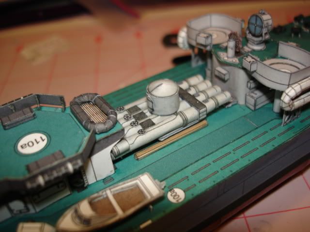

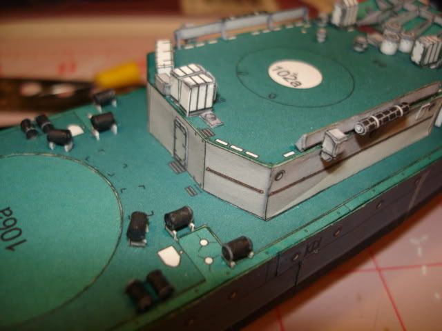

jnyoun
Apr 19, 2007
119
Thanks to the second set of the pictures that Shoki2000 sent to me, most of the parts on the deck could be identified. Also, the pictures showed how to install the boats well. Seems like everything got back to normal.
The following pictures are the current progress. There are some inaccuratly built parts, but they were not fixable. It was too late when I received the second set of pictures. However, I am happy those mistakes are not serious.
Except the bottom, there are not many parts left on the parts papers. So, in next few days, I will be able to add 'mast' and railings.
Many thanks to everyone for valuable helps so far and also thanks to shoki2000 again for your set of pictures.

Superb build !!
One point I think you left off the strips on the formers on the hull sides also I think you put glue all the way down the former edge. If you glue just the top and bottom the frames show less. Christoph always carefully sands the edges of the frames to match the curves as well.
If I'm wrong please ignore the comment
