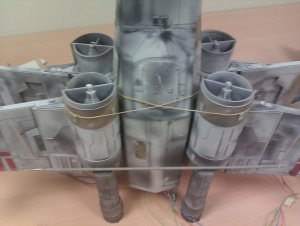

The problem is the wings are closed and filled up with a sheet of carton to give it more strenght.
The wings are attached to the engines..but the underside of the engine is also an open engine so i cannot use a copperbeam which goes from the one to the other wing.
Also i have a metal tube in the fuselage which is used to make it sturdy...wing mechanics and to install the x wing to the wall mount..
and because of the tube i cannot use a large beam to attach the 2 opposit wings.

i slept a WHOLE night about my wing problem..
And the only way i could imagine was to fixate the wings in my position i want..(that's the battle mode)
So i glue them to the hull and i hope that they will stay up.

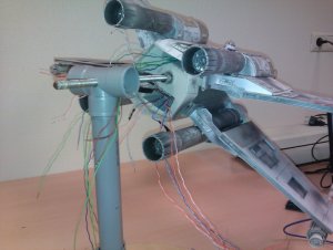

At the moment i'm connecting all the cables...
and yes i made mistakes with the connection part...:)
But untill now all the leds work.
The engine burn and flicker..
the R2 i tested a few of his leds.
Only i have to change the program a little
because i don't connect some of the leds in serial.
example the engine i wanted to connect all the 4 leds in serial.
but i saw that the flicker leds didn't burn that much..
so i scaled that down to 2 leds in serial and that works perfect.
the same with the cockpit..
i wanted to put some LEDs together but now they are getting all there own connector on the ARDUINO
this way is als when i want i can change the light-program without any large problem.
