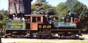

The other mod that I'm thinking about has to do with moving the steam dome on the boiler. I'm going after a look like the one in the attached picture. Has anyone tried something like this. I've got a couple of ideas (basically cutting the existing dome off, filing down the boiler, and gluing a new dome back where I want it), but wanted to see if anyone else had tried something like this, or had any experience that might be applicable.

If your Shay is like the ones I built when MDC first released them, you can use a hacksaw to remove the cast-on steam dome, then file away any remaining traces. While that's not a modification that I made, I did use a mill file to remove the "shoulders" of a Belpaire firebox from an MDC 4-4-2, making it look a lot less "Pennsy". ;):-D Keep in mind when you install the new part that the steam dome should be on the highest part of the boiler, in order to allow the steam to collect there.

I'm about halfway through a rebuild of a narrow guage version. while I'm not performing surgery on it like you plan to Modifying the steam dome should be fairly straightforward. Just keep checking on your fit as you fill off material. It's always easier to remove that add .

Thanks for the input, and helping me realize that I'm not completely crazy. I'm still not entirely sure I've got the guts to take a saw to the boiler yet......
