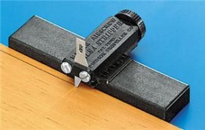

Is there a trick to this thing?
I tried 1/32 balsa and basswood.
It's design and approach is so simple a house trained chimp could use it, but me, I make splinters?

Bulldogowner is right, tilt your blade a little more, make sure you keep the guide against your wood & the down fall for this not many cuts per blade. Also like mentioned don't cut so deep on first pass. Sometimes you can snip the very end of your blade off after a few cuts & readjust your blade to prolong the life of it.

Yes, as mentioned above, the tilt is very important.
Note: Once you go off line on the edge, The cutter will not cut in a straight line. You may have to square the line edge with a steel ruler and knife to keep the edge even. Then start to cut your strips again. Keep the tool close to the edge and fight the grain that wants to pull your blade out of alignment.

Not to beat the tar out of this thing but, I've cut on foam board, self healing mat, my desk top and a wooden cutting board. I've read where some use a straight edge and an 11 in their knives. I dunno???

It can be aggravating...that's why I just buy the stock I need. Guess I'm lucky...I have a hobby shop nearby that carries pretty much all sizes from 1/32x1/32 up to 1/2x1/2. What they don't have, I buy close to size and use an oscilating spindle sander to make what I need. Just don't cut stock on the dining room table.....:(
