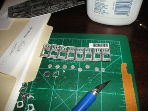

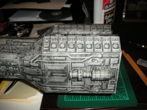

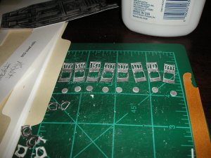

Hey everyone here's another post. I've started adding some more features to the engine nacelles.
The parts that are added are for the top left side of the left engine. It features a lot of little circles and square sections with a lot of rectangular little cut outs. I was thinking that some of the little square cut outs (see below the circles) could be made into port holes for a future project, but they didn't turn out as expected and were very flimsy.
Thanks Kjev for the hole puncher idea!:Drinks: As you can see I've put it to good use.:biggrin:
Square sections separated and trimmed.
Sections mounted to the model.
When textured the circles seem to be more off center than I originally thought, :robot3:but then looking at the original printed texture that's just how it looks.:robot2: Texturing sometimes enhances some features that weren't readily apparent before.
In the mid section of this model is a little mini nacelle section that is slightly off center near the front.:headbange: :frak: If there is a way to remove or change it without damaging the model any guidance would be welcome.

This is coming together beautiful!!!
I really like the detail!!!
Hey thanks master builder! Do you have any ideas about what I can do with that center small nacelle portion that's not aligned right in the front?

Your greebled parts do not look like add-0ns. They look like part of the ship sticking out!! Excellent!! :)
upload_2016-1-23_13-42-58-png.148597
I would simply cut the part off (as close to the surface as possible), cover the scar up by glueing a second print of the area in question over it and attach a new version of the corrected part. :)
RF,
I'll try to implement that. This particular part gave me fits before and this was actually my second attempt at it. I thought that I had it was straight until it was glued in place. It's really just one part that needs to be corrected to make it straight across. It addition to cutting it out, I could wet it down, get it to collapse a bit on one side, cut that out, and laminate the top with a new printed section.
Another option could be that messed up section could have "battle damage" I could rough it up a bit.
Z - Hey thanks master builder!:) I still have a lot to do and some of the sections need to be penciled in a little bit more to remove some glare.
There's some raised laminated sections to build on the sides yet, but most of the parts (on this side) have been cut out.
It's not over yet.

When removing added on parts, always treat the "Hull" as untouchable. You can always make the replacement slightly larger, covering any flubs. Do all the cutting with a very sharp Ex-Acto blade, working your way towards the glue, If you have a heat gun, heat will soften must glues, just don't get it too hot or "POOF!". :fireguy: :)
Z - Hmmm heat gun eh? You're right about the POOF :fireguy:part. Don't know if my skills with a heat gun are that good and this is such a SMALL piece. But, Dr. Seeker knows what to do with the patient. :exterminate: A minor surgery is in order. Time to slice & dice - oh so nice!
Thanks for the advice Z! I'll try not to overcut too much.
