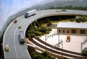

Here's a view from the other end.
Hmm ... a problem of perspective. The broken lines on the road appear to get l-o-n-g-e-r as they get further away, even though they are in fact all the same length. An optical illusion created by the brain's need to perceive "distance".
If it was only possible to view the road from the front, I would just progressively shorten the lines into the distance, but this bridge will also (usually) be viewed from the side.
What to do? I may decide to make it a wide 2-lane bridge (with shoulders) and forget about the broken lines.

Looks good to me. I wouldn't worry about the broken lines. Every critic has to have something to complain about. If the lines get noticed all you have to do is reassure them that you are aware of the problem and that it is caused by an opticial illusion.
What I noticed more is: Here in Oregon the double lines between opposing traffic are yellow not white. But if it is right for what you are modeling, who am I to say it shouldn't be done that way. ;)

Hi Gavin,
Thats one beautiful piece of work you did there and I was very impressed to say the very least. Keep those pictures coming as we all really enjoy them. I wish the Wyoming Highway Dept. could paint our lines that neat. Keep up the wonderful work.
Ron :cool:

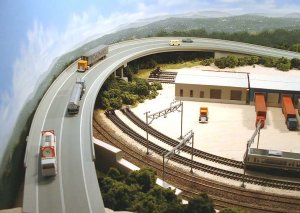

Thanks guys!
I have changed my mind.
The MRD (Main Roads Department) has resurfaced this bridge with just two (wider) lanes and concrete breakdown shoulders.
The wider lanes look more suitable for heavy vehicle traffic on a bridge that services an industrial area.
Solves the optical illusion problem as well - no broken lines.

WOW!!
You've made everything come together so well, Gavin!
A fantastic looking scene!

Absolutely beautiful Gavin!! The road looks MUCH better with two travel lanes and breakdown lanes.
You are an inspiration, no doubt. Your step by step construction photos satisfy my need to know 'HOW did they DO that?!?!'...lol
Now I need to know....what happens where the road comes down to the table??

You're too kind!
At the moment the bridge/road ends where it meets the table (I WAS only trying to hide the hole in my backdrop you know, LOL).
Now my next project is to work on the flat surface around the truck terminals (which, you may have noticed, are not actually properly built yet) and connect the surface roads to the bridge.
I also want to "bury" the layover tracks adjacent to the mainline in "dirt", leaving just the railheads showing.

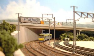

Here, an articulated Light Rail Vehicle heads under the bridge.
