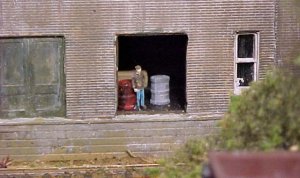

I've got a couple of pics that might help...
On this building, I spray painted the brick walls flat brown, & after letting that dry for 24hrs, I brushed on a thin white wash, & wiped it off with a rag...after that, I sprayed it with a black wash of India Ink & alcohol.

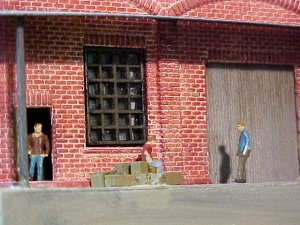

Drew1125
Jan 28, 2001
2,975
Ok, here's the second one...
This time I spray painted the brick flat white, & then dry-brushed (this means a brush with VERY little paint in it) with a reddish brick color...
(btw...always use flat colors when painting structures, for a more realistic look)

I should've added that the dry-brushing takes a little longer...you have to keep brushing on the brick color until it builds up to where you want it.
Also, the technique worked well on that particular kit, because the brick detail was so pronounced.
I used a faily large brush with very stiff bristles.
