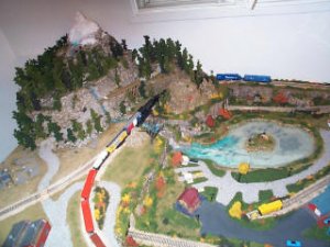

I built my whole layout with the white foam and carved all my mountains and tunnels out of it and painted them and have no trouble i use water based paints. i use the beads as small rock as i just paint them. To each his own but works for me

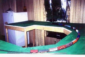

I used the white beaded foam as that is the only kind I could get in this area. Be sure you brace it good. Also if you lean on the edge, it will squash down.

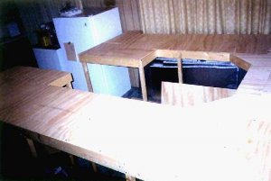

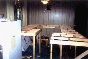

The blue or pink foam will work great. Just be careful not to force too great a curve when seperating the cuts. I have seen the cookie cutter method used on my Son in Law's layout in Oklahoma
I can't resist touting my 1/2" blue foam on 1/2" plywood method ("Oh, sure you can", voices chime in.)
Everything above the table top is 1/2" extruded foam (Ignore the white stuff, it was a mistake!) Four modules connected with carriage bolts.
The cookie cutter method was used for all elevations.
The foam can be cut cleanly with a Stanley utility knife. No mess.
From this...
To this (a few weeks ago)...
It's strong a relative light.
