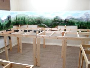

Well, I just finished building the bench's for my layout, now to get into the more enjoyable part right?? This may be boring to some, but maby there's another newbie out there who might find this phase interesting. Will post more pictures as I get the inital track laying complete. In the mean time here's a shot of my benchwork... planeshaings :eek:

Planeshavings,
There is sufficient detail in your photo to show how the most versatile benchwork is put together.
All too often we modellers who use benchwork like yours takes it as being "self evident".
I can tell you that in countries which don't have easy access to the multitude of American "How To" books just get stuck in with what they think is needed. Eventually, they have to tear it down because their benchwork simply isn't versatile enough.
Your benchwork came as a revelation to me when I first saw the method 30 yrs ago. Even today there are thousands of modellers who don't know about it.
I for one thank you for enlightening those who see yours in here.
Errol

Hey planeshavings42
Good looking frames friend, mine started out just the same as yours.

Planeshavings - you post as much as you want to friend. I am sure I speak for lots of people in here who would say that they love to see anything - no matter how 'boring' the sender/poster may think it is.
We all can learn something new from watching others.
And Errol - what you say is so the truth. I raced off and built my own benchwork first off without looking up plans and details and using timber I had "laying around".
Consequence - waaaaay too solid, heavy and quite inadequate for what it should be. Needless to say, turned it into a 'workbench' and am nearly finished mark2 which is the same as Shamus's. :cool:

Great looking bench work and room. I stumbled accross a good idea for doing risers. Use 1 x4's, cut a kerf part way up the center with either a table saw or router. When you put your riser on just use a large washer and large flat head screw through the kert and into your cross beam on the layout. This way when you want to adjust your riser all you do is loosen the screw, make the adjustment, then tighten. Takes away the many many many required clamps or trying to take out a fixed screw and trying to put it back in again. Once you get things were you want them just put another, amaller screw, in through both pieces of wood, don't forget to use a pilot hole for this one. Remember that when using power tools always think SAFETY !!!
Keep the info comming nothing is too boring, we can all learn.
Again great bench work and room, keep the pic of the progress coming. Ron.

Hey, thanx to all for all the encouraging words, and idea's. I must admit I didn't expect to get that much response from a picture of a bench. I had some time yesterday, so I started the inital laying of the track, and found it quite enjoyable, but much more time consuming than I had immagined. Once it's down, and working, I'll take it up and put down the roadbed, and then get the track rusted and ties painted and then lay the permenant track. Will send pictures, when I get the inital layout down, and then the after shots. Thanx again for all the advise and encouragment.

Originally posted by bobrien
Planeshavings - no mention of 'that' ceiling being finished :eek:
You'll be gretting a growling........:rolleyes: :D :D
I know your right bobrien, but I've done nothing but work on that barn for the last two month's, and am burned out on task, was losing intrest altogether, so have started on layout. Once I have the track down and outlined, I plan to take it up and finish the celing, and then put down roadbed and re-lay track. :D At least that's the plan for the moment. Thanx for your sincere concern, and suggestion. AT&SF Duey.
