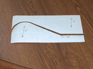

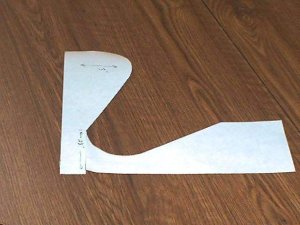

You could cut that sheet of plywood as shown in the following photos to give yourself an L-shaped layout with wider ends.

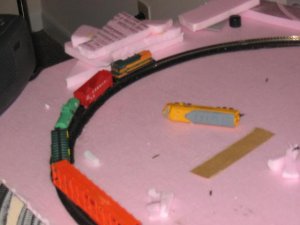

Overhand
this is a picture (taken from my under construction door layout)
you can see the overhang in the orange Autorack at the bottom of the picture
