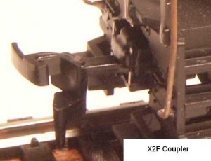

Metal horn/hooks go back to the 50s and 60s, it sounds like any springs which aid in keeping them coupled are shot. Sometimes they were wire or bits of rubber. Getting those old boogers to work will be quite a trick if that is the case. A tip would be to glue a short piece of rubber band to the left side of the coupler box so that it pushes the hook to the right as you're facing it. Since you're only going to run it for Christmas this trick will at least hold them together.

The pins coming down from the coupler are designed to be squeezed together as they were pulled or pushed thru an uncoupling ramp made for them. When slack was given in the train, they would push apart far enough to pull away, leaving the car behind in the siding. It was a good, if not ugly and not entirely reliable way to do switching in a day when there were 7-8 different couplers out there.

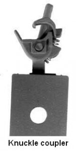

LongIslandTom said:
jej34:
Coupler types attached below. Which ones do you have?
I have the one on the right. Looks like the knuckle coupler

jej34:
The knuckle couplers that comes with Athearns use an tiny spur of plastic to keep the knuckle closed. Problem with that particular knuckle coupler is that the plastic spur sometimes do not provide enough spring tension to keep the knuckle closed well enough, which means the cars can uncouple on curves.
I would advise you to change to a better knuckle coupler. Get some Kadee couplers, which uses a much more reliable brass spring to keep the knuckles closed. Those keep my cars coupled, and this is on 18" curves (and yes, most of my rolling stock is Athearn retrofitted with Kadees).
Most knuckle types come with plastic spring work that fails very easily in storage. As Tom says, your best bet is to replace them with Kadees, #5s most likely, hopefully you have a hobby shop nearby.

jej34 said:
Ok, so the hooks don't get ibnterlocked. To connect these cars I should just be able to pull a car up to the car in front of it and when it locks, that's it? These cars were never used ever ! that's what was throwing me for a loop. Like I said if I keep the speed down. they seem to stay hooked.
Sounds like the earlier knuckles from about 8 years ago that had plastic springs to close the knuckles. In storage, they would be held open and the plastic would "memorize" this and never close again.
