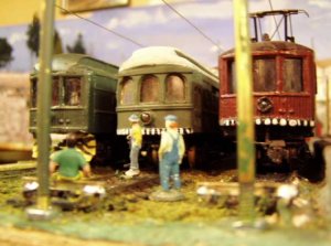

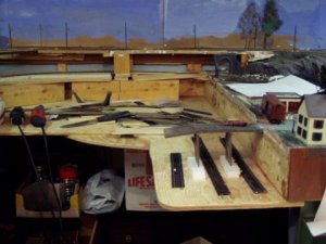

Hi folks,, This is where I started, Trying to figure a way of fitting a small Station in with a lot of movement possibilities.

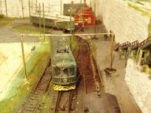

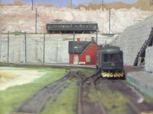

I started the over- head yesterday and finished it today. All throw motors "in" all Blocks "in" and all working FINE phew!!

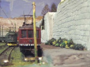

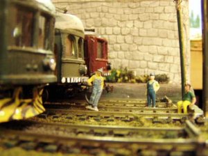

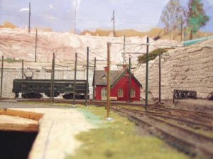

Here is the over-head, I have to finish the car park and set some people in place . Then finish the painting that should do it.:D
belg
power?
I know this is going to be a real rookie question but the overhead wires on these types of locos don't actually do anything for power.There in place only to make the scene look correct?
interurban
Hi Belg, Look close at the overhead and you will see where I block the wire so I can hold a car in different spots i.e. the station or end of track, also notice the end track where the lpb are and you will see I have a metal wheel stop which also puts the same power to both rails.
All wires are hot my friend zzaaapppppp:D

AAAAAAAAHHHHHHHHHHHHHHAAAAAAAAAHHHHHHHHHHHHHHHHH!!!!!!!!!!:eek: :rolleyes: :rolleyes: 'Scuse me rookie:p but one does not model traction using "dummy" overhead (as typer looks over his rims and down his nose at yonder imagined neophite) Now lookit what you done...I gotta go out and hurt a small furry animal to vent my aggressions...."...don't actually do anything..." OOOoooh the pain, THE PAIN....

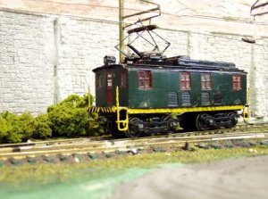

Here is one of my scratch built box motors tick a ticking (air compressor) waiting for duties.;)
