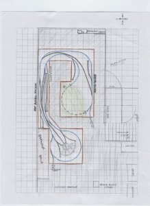

In the next few days, I'm going to try to tweak the plan a bit, include the grades, and try to make the image a little clearer and bigger. I'de like to get some scenery ideas from anyone who has been to that region of New York State. It's a challenge to model an area I've never been to. Trying to find pictures on the web is getting fairly time consuming with mediocre results.
According to a map I was looking at, Batavia is located at the mouth of the Tonawanda River and I'de like to include a portion of that (if feasible).

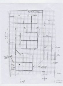

Hi again folks! I'm still armchair modeling this week in devising my new track plan and I thought I'de invite the many talents that reside here to look at and offer alternatives to my ideas. If anyone wants to take a crack at this, here's the criteria:
1.- HO Scale
2.- the bench work is constructed into open grid type modules and can be re-arranged in any fashion .
3.- I don't want to have any duckunders or liftouts.
4.) I need access to the breaker box located on the North wall.
5.) I can't venture the bench work into non-railroad property.
6.) That ridiculous permanent shelving thing in the South West corner can't be moved. (It's81/2 x 2 x 21/2)
7.) I'de prefer some staging area without a helix down!
8.) Keep in mind that the turnouts are # 4 but will be replaced to # 6s as $ allows. The track is commercial code 83 flex and I have a 30 degree crossing that could be used.
9.) I'm not 100% prototypical in my approach but want a very good "general" representation of the NYC line from Buffalo to Batavia circa 1950. (A distance of 30 miles, scaled down!)
10.) I'll be using old fashioned dual cab control with blocks and Atlas components. Turnouts will be all hand thrown if possible.
11.) I do not possess a turntable or round house yet, so whatever you come up with will be taken into consideration when I go to buy or build.
12.) The engine facilities need to service steam (water,coal, sand, ashpit, inspection pit) and diesel fuel.
I'm very excited about the possibilities here and look forward to seeing what you talented folks can come up with. I know you're all busy on your own layouts and don't expect you to construct mine also! I just want to see different approaches and incorporate the best into the final track plan. Credit will be given as much as I can!
Thank You in advance,
Matt--Hershey, Pa.
By the way, the grids on the attached scan are 4 grid blocks equal 1 square foot.

Well, guys, tomorrow is the day...All morning will be spent un-doing wires, back drop and general re-organization... This will continue until Sept. 6th, in-between work of course, then I'll be off to the Delmarva peninsula until Sept. 14th for vacation..
Once I get back, it will be off to the lumber yard for plywood and hopefully by then, the new track plan will be completed and ready to be put in place! Wish me LUCK please!!!!!

Matt, Do yourself a favor and keep those #4 for industrial sidings, get the #6's for the mainline right up front. I wouldn't want to lay down mainline trackage then pull it up to replace turnouts which will require realignment of the tracks. If $ aren't available, try building the switching or yard area first with the #4, finish the main later. Enjoy your vacation!

Advice well taken Gary! I'll most certainly do that... $ certainly is a priority while working on my layout.
I was financially irresponsible in my 20s and I'm suffering from that to this day!! If I hadn't made such ridiculous mistakes in my youth, I would own my own basement with a house over it, have the best quality MRR equipment, knuckle couplers would be installed on everything, DCC would be installed and Atlas wiring components would be gone, etc. etc. etc. etc.
Ah well, I try to have fun with what I have, keep trying to improve my skills and be prepared for that day to come with my dream layout at hand! (And it will sooner than later:) )
If you can't beat 'em, join 'em! Why not line up the the benchwork to the same height as one of the shelves of the "ridiculous permanent shelving thing in the South West corner"? It looks large enough for a small staging area.
If nothing else; the layout in front of the "ridiculous permanent shelving thing in the South West corner" could have scenery extend back to cover/hide part of the shelving thing.

Ron--The problem I have with that corner is the shelf thing is 21/2 ft. high on the "south" end and due to a funny end piece on the "north" end it's 31/2 ft. high. If I try to extend scenery over top of it, I still have the problem of two thin water pipes extending up thru it into the ceiling. The only thing I can think of is try to arrange the backdrop in that area to "hide" the pipes and still not have too sharp of an angle on the backdrop itself.

You could always put in a large chemical undustry like DOW or Union Carbide.
The waterpipes could be disguised as large storage tanks. The high end of the shelf could be boxed in with some large kitbashed buildings from Walthers Cornerstone series or Bachmann's Spectrum City Scenes. :D

D'oh! :D You've been trying to work around that darn shelf thingy instead of over it.
I automatically assumed that it was from floor to ceiling. If it is only 3 1/2 ft tall then it becomes a non issue.
Most people are used to having tables and desks at about 30 inches high to work at while sitting. Workbenches and countertops at about 30 inches high too. In my Canadian Home Workshop Magazine it suggests that a work surface be the height of where your wrist is when your arm is relaxed at your side while standing. For an average person between 5' 10" to 6' 2" this puts the height closer to 36 inches. This is easier on your back because it cuts down on stooping.
For model railroading, the trend these days is to have the benchwork at chest height. That brings the height of the benchwork up to between 4 and 5 ft. A comfortable height for me is about 54" (4 1/2 ft.) This is to allow the modeller to view the trains at a more realistic angle. Instead of looking down chimneys you get a good view of the brake rigging and valve gear on your trains.
This puts your benchwork over top of the shelf.
It also makes duck-unders more comfortable. I saw a picture in the Model Railroader Magazine of a guy who had stratigically placed an old office chair at his duck-under. That way, he could sit on the chair and roll under the layout and then stand back up. No Stooping or crawling.
It makes easier access to the underside of the layout for wiring.
Lots of storage space under the layout.
Paint the walls under the layout black or cover with curtains to keep it from distracting the viewer.
Get a drafting stool. It is like a regular office chair on casters, but it is much taller with a foot rest built in. A bar stool would work too. That way you can sit while working on the higher layout.
Since I work at a Library, I was able to get an old kick stool to use when I need to reach over the layout while working on it.
I hope this helps...... :)

Hi Phil! Thanks for your thoughts... I'm glad you're near an area I'm trying to model...(I may BUG you often when it comes to scenery time).. I was wondering if you had any pics or can obtain any pics of the now defunct Iriquois Beer brewery in Buffalo? I'de like to scratchbuild that if I can't find a commercial kit that comes close.
Hi Ron! Thanks for your input as well. Regarding those darn water pipes; they are very thin and could never be believably "disguised". They run from the meter near floor level, straight up directly through that "ridiculous shelf thing" and disappear into the ceiling. Hell, if I owned this house, they would have been moved a long time ago and the shelf turned into campfire fodder. But since I don't, all must stay as is.:mad:
I thought about my bench work going over top as you suggested, but that would then require the pipes to run up thru my scenery!
Rats.
