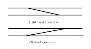

okay - been looking at track online tonight - will go to LHS tomorrow for visual. But what is the difference between Left Hand Crossover turnout and Right Hand Crossover (not just the plain turnout). From the pictures it looks like you can simply flip it around and you get either one.

Left-hand cross overs use left-hand turnouts, and right-hand crossovers use right-hand turnouts (the "handed-ness" of a turnout is based on the direction the diverging route takes - if the main goes straight, and the diverging route goes left, it is a left-hand turnout). They cannot be flipped; well they can, but you get the same thing - flipping it does not "reverse" it. See my picture below.

Ack! I wasn't thinking when I posted that question obviously. (I did have a beer or 4 also ;) )
Of course... flip it over and you have the identical track!
