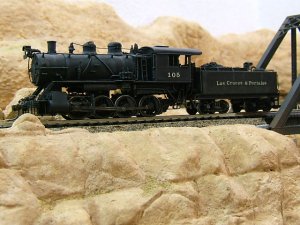

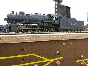

I have 2 brass engines, a 4-6-2 and a 0-8-0. I painted & lettered them for my LC&P. The Pacific runs quite well, but the 0-8-0 was not so nice...I had to replace the gear "tower" and now it kinda "woobles" down the track..I probably threw a couple of wheels off quarter, so I'll have to take care of that now....wall1

Gus, That is one of the most beautiful 4-6-2's I've EVER seen, what's it's prototype? (ATSF?)
That 0-8-0 is impressive as well!! WOW! What's it's prototype?

Hi...Miles, the Pacific is an AT&SF class 3160. It really is a beautiful engine. It is very LIGHTLY weathered, but I see in the pic that the valve gear and rods need a little work....:mrgreen:
I don't recall the prototype for the 0-8-0, I'll have to dig up its box to see what it is.:cry:
The 0-8-0 type is a favorite of mine since I received one back in...well, never mind. An S-gauge AF set that I still have. I have 3 in HO: this one, a PK2 which runs beautifully, and a converted B'mann Mike which runs like a pig....wall1
