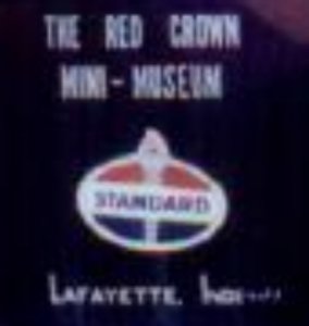

The door on the photo'd side just says:

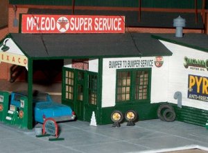

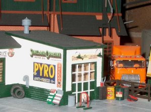

This is a picture of a diorama I built several years ago using a City Classics kit. I did it to try some scenery techniques I wanted to play with. I’ll be tearing it apart and incorporating the gas station into a module that I’m now building.

...<From George D. >... " I did it to try some scenery techniques I wanted to play with."
Well, Geo...looks like you had an absolute rousing success. Any chance you'd like to share how you got that superb looking ground cover?
Pleeeeease? :)

Thanks for you comments, Steve.
There are no special secrets. I started with a base of foam core. After shaping it, I covered some areas that were too rough with plaster impregnated gauze. The rest I left bare. Next came two coats of latex paint. I bought a gallon of an ugly brown from the sale shelf in the paint department at Lowes – just the right shade for a base color. It was flat, not gloss and it was cheap.
After the paint dried I then spread matt medium over it and sprinkled on several shades of Woodland Scenics ground foam. Over that I put some course ground foam and foliage clusters to give it an overgrown look. The nice thing about ground foam, you can simply add more if you want to change anything. Each layer was finished with a good spraying of Scenic Cement.
The dirt near the “pavement” came from my back yard. I sifted it through a piece of old pantyhose. A strong caution here, don’t use your wife’s new pantyhose. For oil stains, I added shoe dye diluted with alcohol with an eye-dropper
The “concrete” is styrene that was scribed for the expansion joints, painted and weathered with chalks.
Building a diorama is a great way to get comfortable with scenery work. I’ve since done a lot of scenery work on our club layout. I hope I’m not to getting too far off topic, here’s a picture of an area I did on our club layout.
