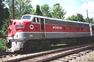

Also the wagontop locomotives (like this EMD F-7) had anticlimbers on their noses. On this pic sunlight and shadows model clearly the ribs on the 'bumper' above the coupler, just like Hunkiedoo explained.
Ron

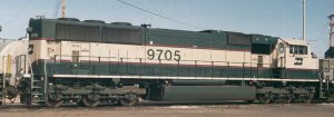

On the pic of the GP38-2's look for what appears to be extentions of the walkway in front of the nose. If it is a large anticlimber it will extend about 3-4 feet forward and if it is a small one, it should look like a small angeled peice extending only about 1 foot.
They are supposed to keep one locomotive from climbing up onto another if they are involved in a head-on collision.
Terry
Here's an illustration of what Terry talked about. This anticlimber is painted white (rear of the loco above the coupler) as part of BN's scheme, and is an example of a large anticlimber. Can't find a picture of a smaller one right now.
