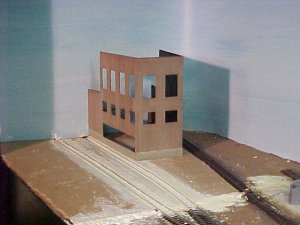

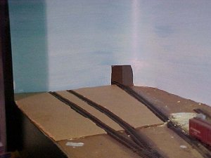

This might be a rerun for some of you, but I thought I'd show how this kitbash was dictated by the shape, & size of the available space.
I started with a 2-track spur, a main line going to the rear, & an exit hole in the backdrop that needed to be hidden.
I used pieces of cardboard for a base.

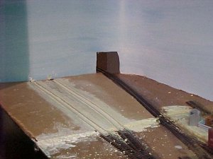

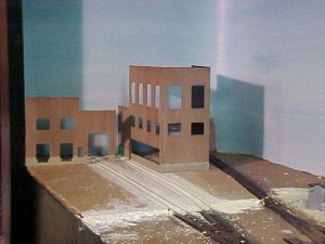

I decided to pve over the tracks, with spackling, & started test fitting pieces I cut to fit from a Walthers Superior Paper kit.

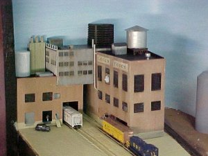

I needed something to bring the two seperate buildings together...the answer came in the form of some pieces from a Walthers coal mine kit...
With some roof details, here's what I ended up with...
I named it Leigh Foods after one of my daughters, who's in culinary school.

Great looking solution to the problem!!!:cool: :D I'm going to have to do the same thing - hiding an exit - several times on the layout I'm planning.
It's nice to see the work in progress photos.

I just noticed this thread today. Thanks for the multi-pic "how to" series above. I like the look of the building; very industrial, gritty, and interesting with the connecting piece that differs from the other sections. It looks like many I've seen in the Minneapolis/St. Paul area.
