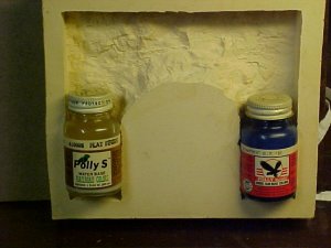

Hey Tom, Hmmmm problems with Poly Scale?:eek: :confused: That stuff is about bulletproof. Something ain't right:eek: If you used windshield fluid to thin it something may have reacted:eek: I use distilled water like you get at the grocery store to put in steam irons. Thin the Polly Scale about 50-50.
I'm just wondering, are you sure you had Polly Scale? Floquil also makes a paint called Polly S which is latex based and it will clog up an airbrush like a constipated cat!!!! The reason that I ask is because I went into the LHS and asked for a bottle of Polly Scale Black and Doofus handed me a bottle of Polly S and told me it was the same thing which it isn't. Here's a pic of the bottles.

PS: Sorry about the yellow cast to the pic...I turned on the wrong lights:eek:

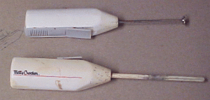

On the subject of mixing the paint prior to thinning it....shaking the bottle ain't gonna do the trick:eek: The Polly Scale paint has to be stirred. Shaking the bottle cause air bubbles to form and degrades the paint and causes it to thicken when stored.
I got mighty tired of stirring the Polly Scale with a small stick. One day while at the Wal~Mart I came across a gizmo called a Betty Crocker Portable Drink Mixer. Actually there were two versions of the thing, one with a plastic rod and one with a metal rod. Both work extremley well for mixing any kind of model paint. They run off AA batteries. If you get the version with the plastic rod rewire the thing so it only runs on 1 battery. Its too fast with 2 batteries and slings paint all over the place:eek: The metal one works fine without modification. The one with the metal rod must be for mixing stronger drinks:D :D :D
Hopes this cures some of the "ills" you guys have been experiencing with PollyScale.:) :)

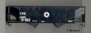

Time for an update.
I noticed that the Folk Art paint that I airbrushed onto the cars was not adhering as well as I would like it to. So as an experiment I took two cars a hopper and a box car and sealed them with a matte finish. After the sealer dried the paint adhered perfectly. You could not scrap it off.
Last night I airbrushed the hopper and it came out great. Now I will seal it before I begin adding the dry transfers. I will try to airbrush the box car tonight. When I get a chance I will post some pictures.

The sealer I used was Patricia Nimocks Matte Clear Acrylic Sealer by Plaid. It did the job but I don't like it as a final coat. I think it is too glossy. You can see when I post the pictures shortly.
TomPM
Another Fried Egg Fan
Ok so here is the picture of the final product.
The car was an Atheran undecorated 34' offset hopper. The lettering is from a CDS LNE 2-bay offset hopper dry transfer set.
I am not thrilled with the matte sealer I used. I think it is too glossy. Weathering the car will take of the glossiness.
