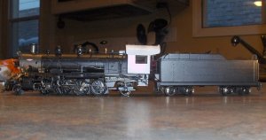

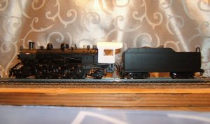

Okay so I have been playing with a scratchbuilt cab on a Bachmann Mike to do a freelanced back date on it. I have now made 2 attempts to apply an .015 wrap of styrene that I studiously embossed with rivets. The initial application looks good but after a few minutes the solvent cement starts to attack the .015 causing wrinkles and bubbles. Second attempt I used less solvent but with the same result. I was using Testors liquid cement as in my experience it tends to be the least potent of the ones I have worked with (plastructs and ambroid being the other liquids I generally use).
I have now had to re-sand the roof of my cab twice and I am not sure if my nerves or the cab roof will take another failed application. I know some of you apply styrene wraps to scratch built tenders with success so what am I doing wrong? the cab took a few hours of messing to get the roof line right and it looks amazing except for the missing rivet details.....
I do not want to give up on this!
