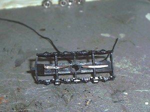

These are wipers I installed on a Bachmann 0-6-0. The wipers are from a 70s era Bachmann F9. They fit without any modification other than soldering wires to them. I also added some weight in the tender.
Only 2 wheels per truck pick up power through the axles. I have tried all wheel pickup with wipers to the wheels but it created more drag. and limited the amount of cars the loco could pull and didn't add much more reliability.

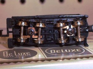

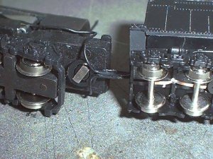

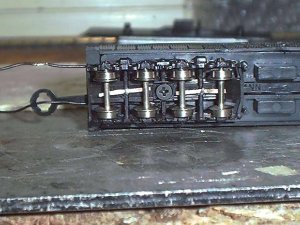

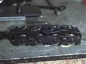

I have cut my own wipers from .003" phosphorous bronze sheet with scissors or a paper cutter.
They do deform when you cut them (curl up like a pigs tail) and need to be straightened out.
I solder a wire in the center, feed the wire through a hole drilled in the truck and glue it in place.
