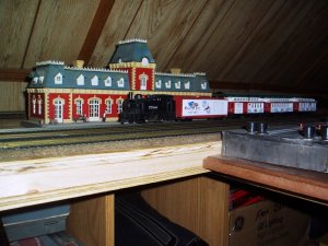

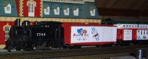

A monster locomotive pulls the Freedom Train into Frankford station.
frank
PS just havin a little fun.
