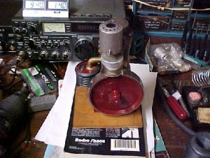

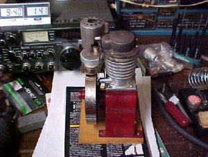

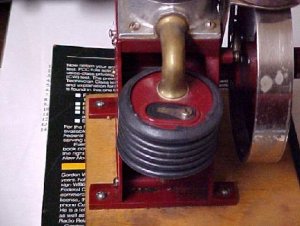

The picture below is a REBI "Flame Licker" Hot Air Engine. It was made in Germany shortly after WWII. It works on the same principle as a Sterling Hot Air Engine. It was a present to me from old St. Nick more years ago then I care to remember. It was one of those things from my childhood that got "tucked away" but sadly in a bad state of disrepair.
Now, thanks to the advice of a gentleman in Oklahoma who is a professional restorer of rare toys I have been able to return it to running condition. Would you belive the parts I needed came from a John Deere grain drill :eek: :D :)
Now that it's running a good cleaning is next and on the mantel it goes to enjoy for another 60 years!!!

Essentially, Heat from an alcohol burner is sucked into the engine by an expanding and contracting bellows which is linked to a flywheel which in turn by means of a cam opens and closes a valve which allows a partial vacumn to be created and then exhausted thus creating a reciprocating motion by other linkage back to the flywheel. As long as the heat source remains in place the action is repeated over and over at about 250 RPM.
Do a Google search on Sterling Engines....I think they were invented in Scotland or somewhere close by.

Tyson....It don't do nothing but go round and round and go pop, pop,pop!!!:D :D It was one of those "educational toys":D Actually there were some little minature machines such as a saw, generator, drill press, and etc that you could power with it.:thumb:

Neat Vic, another entry into 'how things work'. Hmmm, if the flywheel drives the bellows does it need to be 'kick started', given a shove to get it going?
Now I find it hard to believe that you haven't built something for that little engine to drive. Surely you could transfer that power, by whatever reduction needed, to animate some other antique toy or some other device of mechanical amusment. ;) :D

HI, TBGF, You hit the nail on the head!:D You have to give the flywheel "a flip" to start it. There's no piston inside of the cylinder, its simply a chamber for the collection of the heat.
Actually, I'm wheeling and dealing right now on some of the original little machines that the engine was designed to run.
