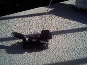

Ever since I was a kid, I always wanted to ride in my trains. Thanks to the folks at www.wirelessmicrocolorcam.com and some funding raised thru the B&MC's management selling off excess inventory, I've now been able to do just that....sort of.
With camera in hand and some helpful tips from Model Railroad New's product review, I modified an old Mantua F7 dummy unit to carry the camera on the front truck. This is so that the camera will follow the track on curves, rather than aim out beyond curves with the loco's overhang. After filing it down to a 5 degree downward tilt, I mounted it with double sided foam tape. While the picture shows the wire tied to the rear of the truck, in practice this proved a derailment hazard and was removed.

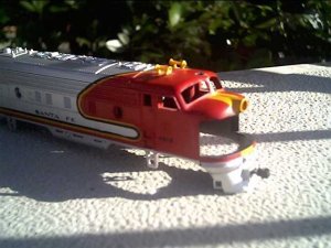

shaygetz
Ala "Monster Garage", I wanted it to look as stock as possible. I carefully cut a portal thru the nose with a razor saw and filed it clean. Again, in practice, this proved a derailment problem and was modified to look more like a "grin" as will be seen in the final picture.

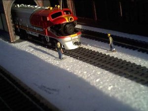

shaygetz
A hole was provided in the roof for the antenna and this shot shows the "smile" it now sports to clear the cable and screws on the sides of the camera.
Hiram and Billy Joe Ray Bob are now squarin' off to see who gets to ride first.
The future will bring a super bright headlight to help in low light conditions and a touchup on the paint. Even though I'm a Beano fan, I just can't bring myself to paint over that "Warbonnet" paint scheme.
By dumping off some old track and some old NASCAR stuff on Ebay, I was able to do this for less than $30. Even if I laid out the coin up front, it would still have only set me back less than the price of one of the newer locos. The effect, while not broadcast quality, is very striking, especially when someone "whistles off" as they pass you.
