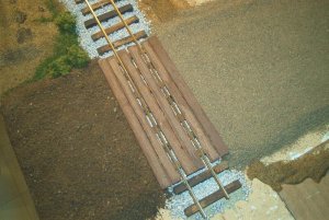

As I continue along at my usual snail's pace, I have put down the level crossing and the rest of the road. Interesting to see how the sifted dirt that I use does not faed back to the original (right side of crossing) light colour, but stays as dark as when soaked. (left side)
The "sand" is exactly that...fine sifted sand that I picked up, dried, sifted, and ran a magnet through. I think that it is possible to stain the sand in areas too, in order to avoid a monotonous one-colour look.

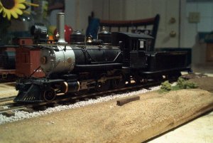

Thanks for the compliments on the locomotive, but I can't claim anything. It's bone stock. AllI did was strip the original Pennsylvania paint scheme from it, and even that is not finished yet.
It might be small, and really rudimentary, but I am LEARNING stuff. Any mistakes made here hopefully means less mistakes made on a "real" layout.

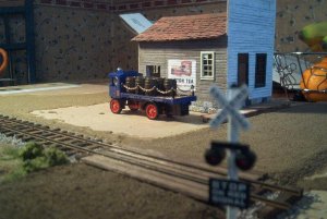

As you can see, I still have a way to go. This diorama will be used to display the following...
--Rolling stock
--Scratchbuilt buildings ( max 1 or 2 at a time)
--Small trackside features, such as a water tank, sanding facility, etc.
--Vehicles, people...etc.

Looking good Steve! I agree that a small diorama is a great way to practice modeling skills - it's fun - and it's a lot easier to get done than a big layout!
Just one thing though on your level crossing. Shouldn't you have an inside guard rail (like on a turnout) to keep your flangeways clear? This was suggested to me by someone who handlays in-street track: just take a second piece of rail and lay it inside the main rails on its side, leaving a gap for the flanges.

Val, that's a good point. I'll have to check, as I am pretty sure that it was done for poured concrete crossings, as well as track in the street. I'm not sure if back-woodsy plank crossings were treated as well as their citified brethren.:)

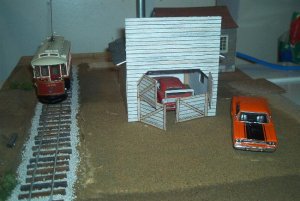

Here's a shot of the mockup of a blacksmith shop that's become a garage and gas station, as horse traffic dwindles. I really should get ahold of something more time appropriate that these Mopars...:D
