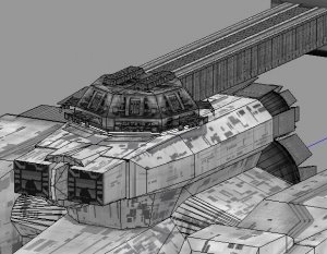

progress ~ did a bit of tweaking and additional texturing + scaled the Nostromo mesh to the refinery + prepped the engine parts for test building.

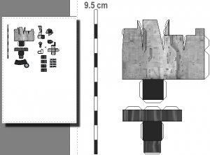

Progress ~ Uggghh.. the parts for the Nostromo's engines are TINY! I didn't even get past the first few parts before a need to re-design was obvious. I would have like to retain the recesses in the forward intake of the engine ( the orange bitz in the 3D pic posted earlier) , but the parts are just way to delicate for the average modeler ( meaning me) I've simplifying the engine even further, which has reduced the part count down to 8 (-) the fins. 'Take two' on the test build, in progress.

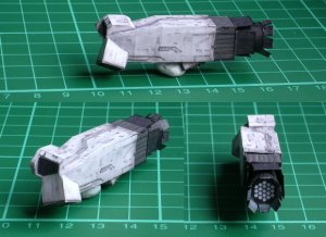

Ok, the Nostromo's engine is build-able at this scale ( if I can do it, anyone can) I used standard printing paper coated with several heavy coats of spray acrylic. *The standard paper proved very weak for the main sections. Ideally a combination of standard paper and card would be best when building a Nostromo at this scale, but I'm not going to try to second guess builders, so maybe just a note/recommendation in the AG.
Next on the board the Nostromo's main hull.. + some sort of solution to the refinery's texture dilemma so a test build can commence..
*pics* ~ A4 cutting board ~ centimetre scale

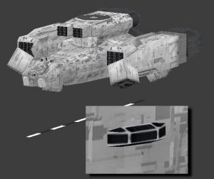

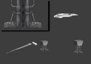

Progress ~ nearly finished texturing the main hull. I figure a few ppl would prefer to just build the Nostromo without the mega refinery, so I've spent time making an insanely small under carriage ( just 2d shapes) the main nose antenna and a few small detail etc the cockpit window is there, though I doubt its build-able ( about 4~ 5 pixels wide as a pattern.) :eek:

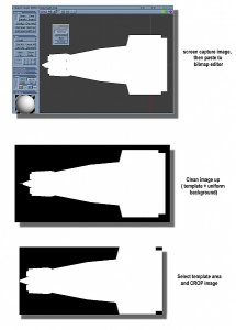

MAKING TEXTURE TEMPLATES
TextureTemplates1.jpg * Again there are a number of ways of doing this, in META ~
* I either, Select [View] [MQR] OR delete all the textures to get a vanilla view of the 3d model.
* Select the view you want for the required textures [F1] side [F2] top ( I rotate the model 90 degrees clockwise, because I have a phobia about working vertically) [F3] Front
* Zoom in so the model/template fills the working area.
* Screen capture and transfer / Paste the image to your bitmap editor.
IN THE BITMAP EDITOR
* Clean up the image (all you want is the template and a uniform background)
* The most important bit ~ Select the template area with what ever selection tool your editor has ( magic wand ?)
* [Crop] the image and save it as a base working file. Its now a perfect fit for the 3D model, what ever textures you overlay onto the this template will be a WYSIWUG when applied to the 3d model.

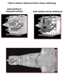

ADDING PANELLING TO A BASE TEXTURE TEMPLATE..+ shading
Referring to the method on the gfx attachment + post # 189 in the Sulaco thread linked above.
* When you paste (as a transparency) the panelling into the base texture, [Select] [Invert Selection] so that you can now edit the main image without touching the panelling.
* using what ever tool you wish ( airbrush) ( retouch ~ Lighten or darken) add some shading to the image wherever appropriate.
* Save it as a Texture file (re-named) for you 3D model.. ** I usually prefix texture files with the abbreviation 'TEX' to avoid over writing a working file and /or getting confused ( happens lots to me)
Pheeeww.. Clear as mud..? . This method has Flea's and it could easily be done using layers in many bitmap editors, its just how I build most of my textures ~ sorry the explanation was so convoluted with broken gfx ~ I hope it made sense.
*I'd encourage Dev's to experiment with their textures. A bit of shading makes a refreshing difference and gives a model a bit of depth ~ compared to the uniform textures we usually have to work with, or that usually accompany a 3D model.
:mrgreen:

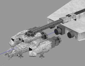

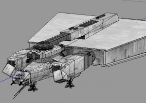

progress ~ Mmmmm.. The perils of P*** Poor Planning. Had to go back a step and properly mate the mini-stromo to refinery's platform. * I should have developed them as a single unit in the first place.
The Nostromo will be to small for an edge (card) grip to the gantry arm, so a small magnet seems likely as an alternative. The sliding arm will also have to align the Nostromo, so the engine bells engage their housings in the platform ( approx) A moot point at this scale, but I'd like it to be work-able at least.
Abandoned the fancy texturing on the refinery in favour of a general gunge ( avoids any detail placement problems ~ builders can stick panels anywhere)
