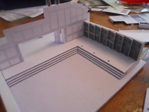

A few progress photos for this weekend;

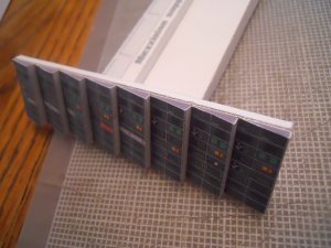

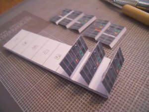

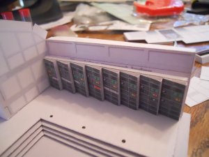

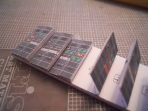

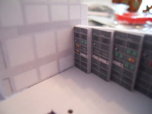

Working on the Computer wall today.
Each panel gets glued down on one side...
After all of the panels are attached on one side, I begin glueing the other side down using the previous panel as an anchor.
The result is a part where everything lines up correctly and actually fits where it's supposed to go!
I'm still working on the balcony stairway but will probably get the walls up in the main room before I finish them (but I never know!).

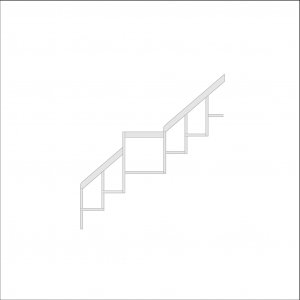

This is the first serious work on the balcony stairway. This is a composite of the upper and lower stairways (they are actually positioned at right angles to each other).

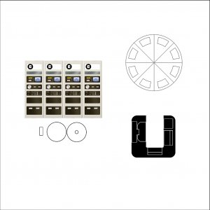

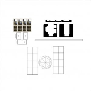

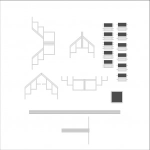

...and, since I have to make templates for the scratch build anyway, I thought I would do some furnature. The template for the office com-post, the big conference table and the commander's desk.

I've "tweaked" a lot of things in my life... enough to know that tweaking is what I do if at all possible. That being said; I have tweaked this model more than anything I have ever tweaked in my longish life! This is a study model, built to get the lay of the land on a subject before I start building it out of plastic. I'm not only glad that I did this first but I'm starting to experience a modicum of pride regarding the detail that I'm achieving.
I believe I have completed all of the templates (having tweaked them within an inch of their lives!) and will spend the remainder of the week building the model. Photos will follow (of course) and please, be as honest and crittical as you will.
I've finished the balcony stairway

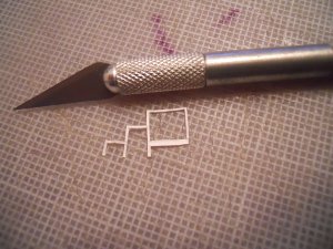

the parts are TINY!!! So they are double sided and will be folded over for added strength and depth.

The redone (YET AGAIN!!!) dividing wall and computer wall joined and happy together at last.
The first panels of the balcony wall installed behind the computer consoles.

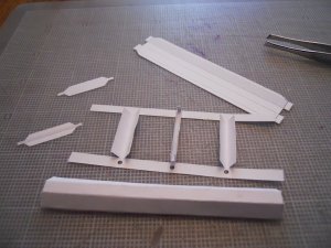

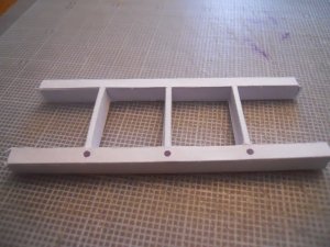

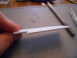

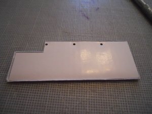

And then, another snag! I printed parts for the balcony and assembled them several different ways but kept coming up with the same problem;

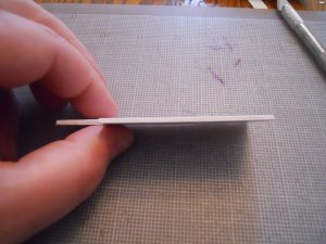

Heavy duty warpage!
Solution:
Use a thin piece of corrugated cardboard to stabilize!
It worked better than hoped!

I've also been tweaking the furniture for accuracy. Here we have the com-post with accurate stand, the commander's desk much more "fleshed out" and the conference table complete with stand (these are on either side of the tabletop).

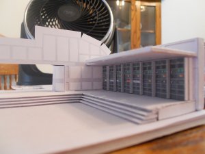

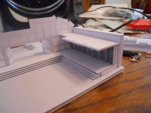

A quick update on this Sunday evening;
The balcony is glued in place and the fit is very good. Also did the round panels on the dividing wall.
Another view of the balcony in place. This is farther than I got last time so I'm quite pleased and relieved.

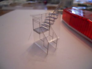

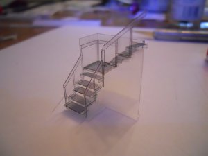

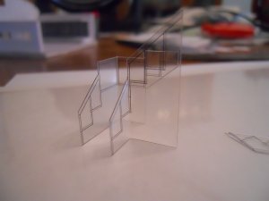

I've also started work on the balcony stairs and as I feared... They are too delicate when cut out to function
There is no way I could glue the individual stairs on to this flimsy piece.
My solution is to use transparencies for the delicate pieces and then glue the card stock stairs onto that.
It won't be perfect but it will be a decent representation of what is supposed to be there. Gluing the stairs on will be extremely difficult.

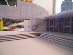

The steps on the upper portion of the balcony stairs are finally in place!

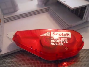

After trying about ten different kinds of glue, I took a chance and bought this adhesive roller on clearence. It worked even where rubber cement failed!
The finished balcony stairs. Not perfect but definately the best I can do on such a small model
The stairs installed!

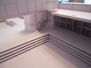

Another view; here you can see the railing next to the stairway on the balcony itself.
This part really kicked my butt but now that it's done and acceptable, it's on to the balcony walls and ceiling panel and then the columns and railings in between them. After that, all that is left is the command office and whatever furnature I want to try and do.

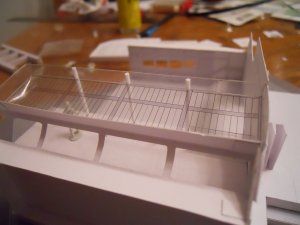

I managed to get a couple of the balcony wall pieces up tonight.

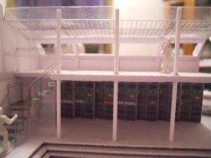

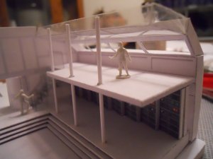

The balcony picture windows and AC section in place with columns added. Looking more and more like the real thing!
Another angle with female Alpha tech figure for scale. Looks like I may have to shore up the frames in between the windows as they are buckling a bit..
A view from behind the model showing how visible the balcony is and will be on the scratch build. I did the AC section as a transparency for this study model but will build all of the detail into the scratch build leaving the back open so you can see through the louvers.

Update:
I've glued the last of the ceiling panels that will be permanently attached to the model.
I've left the main wall of so I can still tweak the inside if need be. There are other ceiling panels that will be added but they will be removable for viewing.
I'm going to add some thicker cardstock to reinforce the picture window section as it's bowing somewhat but that should be fairly simple.
a view from below. Won't be able to do that once the main wall is up.
Still have to install the railing in between the balcony posts and glue the posts themselves to the floor but after that, I can install the main wall, finish the commander's office and that's pretty much it.

This is fantastic! You are going a great job coming up with all this detail on the fly. I also use a lot of chipboard and cardboard for reinforcement. I use a lot of white cover stock (postcards, business cards, book cover) to make small parts like those stairs. It's thicker and sturdier than regular card and could work well for something like that. Our local Hobby Lobby carries a lot of it and in several colors. Also, I sometimes use a little Super Glue around the part edges to "seal" them and that helps them stiffen up and keep their shape.
